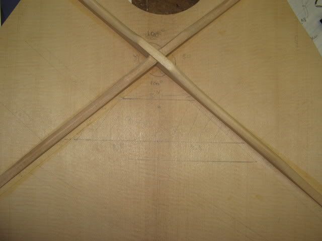

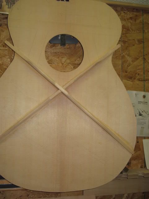

Well My X brace wondered off centre while in the go bar deck...see pics
It seems solid, I profiled it  a bit...( even though it left a smear of glue...)
Any problem just leaving the blasted thing where it is( call it an experiment) or should I remove it and try again...( top has 25 ' radius if that would make a difference)...If removal is recommended, what would be the best way to do that ...whittle it off till I bottom out and reach the top, or can I use heat to get it off( glued with titebond,   or some other way.. ..I humbly await direction .....Thanks...

If it's not a guitar for a customer, I'd leave it on if it were mine. At least it shifted toward the treble side, which wants more stiffness for the higher frequencies. I've seen so many variations on bracing in the 9 months I've been frequenting luthier forums that I don't think that small a change would make a huge difference.

Finally something I have experience with. My first guitar, a kit but with handmade braces, did the same thing in the go-bar deck. It moved probably 1/8th of an inch (if not slightly more).   The builder I was working with said the ssame thing Gene did, which was this:
Make certain the bridge plate will still nestle firmly between the braces, and firmly below the bridge, with the outside wings of the bridge crossing over the braces and with enough room for the string holes to fit reasonably on center. If it does, you're golden...if it don't you'll want to seriously consider taking it off. Mine did, so I left it alone, and it turned out to sound just great.
I think you're probably good to go.

Although it would most likely turn out fine and like Bill mentions, as long as the wings of the bridge will fully straddle the xbrace, you will be fine , personally I would take it off an re-do it simply because that's not what I planned. This is one thing that Paul Woolson has taught me over the past several years of being here on the OLF. Make it right and you won't be tempted when/if something else will be "good enough".
PostPosted: Fri Mar 16, 2007 4:57 pm
perhaps my eyes are deceiving me, but being a bit off center does not seem to be the only problem. the spread of the x would appear to be exceedingly wide, like about 120*.
it does not look as though a normal 6" steel string bridge might span the lower bout spread at the likely bridge location.

Whether it's off center a little would be of no concern to me; however, IMO it is absolutely imperative that the x-braces catch the sides of the finished bridge. If they do not cross directly over the bridge, the instrument's tone suffers, and from a structural standpoint the guitar would be much weaker.

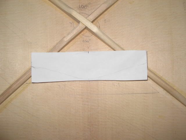

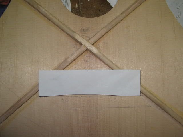

Thanks so much's folks.. I took some more pics and I think I'm in trouble...
my x brace angles are on the pics, but I put on my bridge blank size and location ....

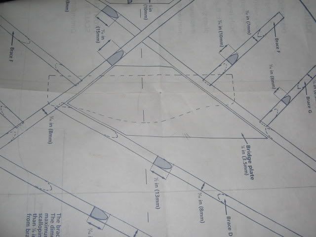

Here are the plans..
.my bridge blank is not wide enough( only 4 '') to follow thru with the suggested bridge plan shape( 4.4'')..Kinkead book...so in the photo I just cut out of paper my bridge balk size and layed it out....
Thanks for all the help so far...what's the consenses now?
Could the bridge blank be trimmed so it looks sort of like this.... or would the wings be too small?
and maybe move it a little towrds the neck and just bump back the saddle location on the bridge the same amount?...oh s*%&...I'm starting to reach for the chisel...help!!...sorry for all the hastle ..but hey..it's still fun...I'll work on something else for a while and see what you say...

Plans are only suggestions--reasoned ones, but suggestions nonetheless. I don't know if this would work in your case, but you can always make your bridge longer so both wings span the "X". You can also make a bridge plate to whatever size and shape you need.
On the other hand, if this anomaly is going to decrease your excitement for the rest of the project, then take those babys off, start over and rest easy at night!

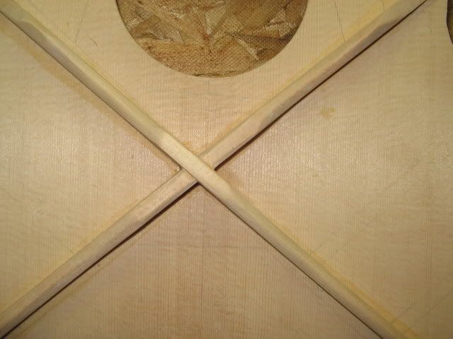

I did the same thing--I don't thinyou'll be happy unless you remove them. You can heat them, but I took my SM glue clearing chisel and took them all the way down and then sanded the glue off bith the orbital--worked fine and pretty quick.

Hi Took off the X brace..no problem ..thanks..I probably would have left it on if there wouldn't have been a bridge placement potential problem..but glad I did...
ROOKIE QUESTION..hey why is the X brace joint not glued( or is it and I missed something )..  .. if it isn't.. is it because of the room the glue would use up and perhaps potential shrinkage after drying
